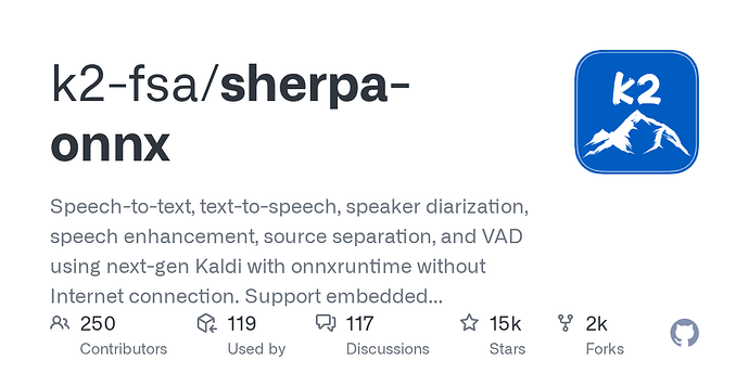

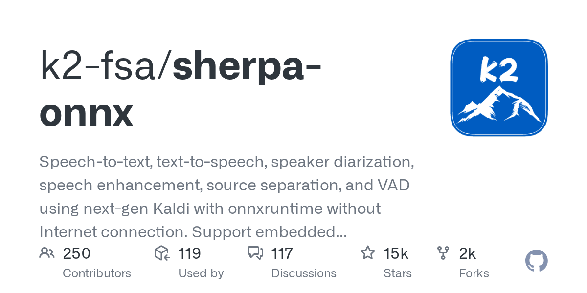

This is pretty good. I’m currently validating the sherpa-onnx WASM + English Streaming Zipformer 20M INT8 local ASR solution. Thank you very much! :folded_hands:
