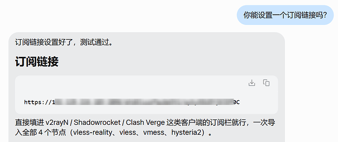

Can you set up a subscription link?
I discovered while testing with Shadowrocket that the Reality protocol wasn’t working.
It was probably because Xray-core v26.9.9’s REALITY forcibly requires the client’s first key_share in ClientHello to be X25519MLKEM768 (0x11ec), with X25519 optionally following it. Clients missing this key share are rejected outright.
So I switched to a different core.
Replace the server’s core with this one:
https://github.com/crazypeace/Xray-core-fork
After muse finished, my Shadowrocket test of the Reality node worked.
