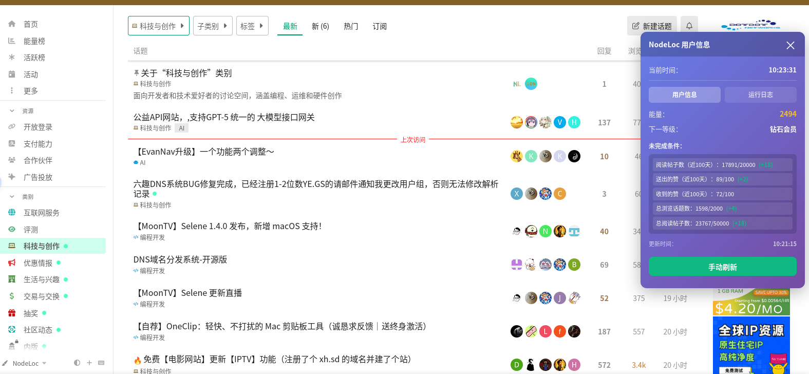

Wrote an upgrade progress plugin to nudge myself to upgrade
Diamonds are too hard; use AI to write a Tampermonkey script that nudges me to slack off and level up, showing the upgrade progress after each opening (auto‑refresh every 5 minutes or manual refresh):
Currently there is a bug where using the default avatar fails to retrieve data, looking into how to fix it The loading bug has been attempted to fix.
Code reply visible:

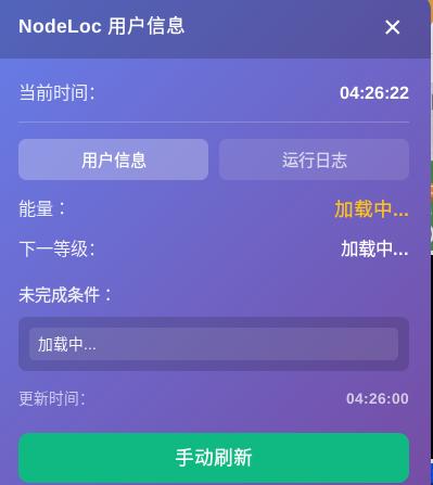

    // Create floating control panel
    function createControlPanel() {
        const panel = document.createElement('div');
        panel.id = 'nodeloc-user-info-panel';
        panel.innerHTML = `
            <div class="panel-header">
                <span>NodeLoc 用户信息</span>
                <button id="panel-close" title="关闭面板">×</button>
            </div>
            <div class="panel-body">
                <div class="status-row">
                    <span class="status-label">当前时间:</span>
                    <span id="current-time" class="status-value">--:--:--</span>
                </div>
                <div class="divider"></div>
                <!-- Tab navigation -->
                <div class="tab-navigation">
                    <button class="tab-btn active" data-tab="user-info">用户信息</button>
                    <button class="tab-btn" data-tab="logs">运行日志</button>
                </div>
                <!-- Tab content -->
                <div class="tab-content">
                    <!-- User Info Tab -->
                    <div class="tab-panel active" id="tab-user-info">
                            <span class="status-label">能量:</span>
                            <span id="user-power" class="status-value highlight">加载中...</span>
                        </div>
                        <div class="status-row progress-info-row" title="点击刷新进度">
                            <span class="status-label">下一等级:</span>
                            <span id="next-level" class="status-value">加载中...</span>
                        </div>
                        <div class="progress-section">
                            <div class="progress-header">未完成条件:</div>
                            <div id="unmet-conditions-list" class="progress-list">
                                <div class="progress-item">加载中...</div>

        // Add styles
        const style = document.createElement('style');
        style.textContent = `
            #nodeloc-user-info-panel {
                position: fixed;
                top: 20px;
                right: 20px;
                width: 320px;
                max-height: 90vh;
                background: linear-gradient(135deg, #667eea 0%, #764ba2 100%);
                border-radius: 12px;
                box-shadow: 0 8px 32px rgba(0, 0, 0, 0.3);
                z-index: 999999;
                font-family: -apple-system, BlinkMacSystemFont, "Segoe UI", Roboto, sans-serif;
                color: white;
                overflow: hidden;
                display: flex;
                flex-direction: column;
            .panel-header {
                display: flex;
                justify-content: space-between;
                align-items: center;
                padding: 12px 16px;
                background: rgba(0, 0, 0, 0.2);
                font-weight: 600;
                font-size: 14px;
                cursor: move;
                flex-shrink: 0;
            #panel-close {
                background: none;
                border: none;
                color: white;
                font-size: 24px;
                line-height: 1;
                cursor: pointer;
                padding: 0;
                width: 24px;
                height: 24px;
                display: flex;
                justify-content: center;
                border-radius: 4px;
                transition: background 0.2s;
            #panel-close:hover {
                background: rgba(255, 255, 255, 0.2);
            .panel-body {
                padding: 16px;
                overflow-y: auto;
                flex: 1;
            .status-row {
                display: flex;
                margin-bottom: 10px;
                font-size: 13px;
            .status-label {
                opacity: 0.9;
            .status-value {
                font-weight: 600;
            .status-value.highlight {
                color: #fbbf24;
                font-size: 14px;
            .divider {
                height: 1px;
                margin: 12px 0;
            .progress-info-row {
                cursor: pointer;
                padding: 4px;
                margin: -4px;
                margin-bottom: 6px;
                border-radius: 4px;
            .progress-info-row:hover {
                background: rgba(255, 255, 255, 0.1);
            .progress-section {
                margin: 12px 0;
            .progress-header {
                font-size: 12px;
                opacity: 0.9;
                margin-bottom: 8px;
                font-weight: 600;
            .progress-list {
                background: rgba(0, 0, 0, 0.15);
                border-radius: 6px;
                padding: 8px;
                max-height: 200px;
                overflow-y: auto;
            .progress-item {
                font-size: 11px;
                line-height: 1.5;
                padding: 4px 6px;
                margin-bottom: 4px;
                border-radius: 4px;
                word-break: break-word;
            .progress-item:last-child {
                margin-bottom: 0;
            .delta-positive {
                color: #10b981;
                font-weight: 700;
                margin-left: 4px;
            .delta-negative {
                color: #ef4444;
                font-weight: 700;
                margin-left: 4px;
            .control-btn {
                width: 100%;
                padding: 10px;
                border: none;
                border-radius: 8px;
                font-size: 14px;
                font-weight: 600;
                cursor: pointer;
                transition: all 0.3s;
                margin-top: 8px;
            .refresh-btn {
                background: #10b981;
                color: white;
            .refresh-btn:hover {
                background: #059669;
                transform: translateY(-1px);
                box-shadow: 0 4px 12px rgba(16, 185, 129, 0.4);
            .control-btn:active {
                transform: translateY(0);
            /* Scrollbar styles */
            .panel-body::-webkit-scrollbar,
            .progress-list::-webkit-scrollbar {
                width: 6px;
            .panel-body::-webkit-scrollbar-track,
            .progress-list::-webkit-scrollbar-track {
                background: rgba(0, 0, 0, 0.1);
                border-radius: 3px;
            .panel-body::-webkit-scrollbar-thumb,
            .progress-list::-webkit-scrollbar-thumb {
                background: rgba(255, 255, 255, 0.3);
                border-radius: 3px;
            .panel-body::-webkit-scrollbar-thumb:hover,
            .progress-list::-webkit-scrollbar-thumb:hover {
                background: rgba(255, 255, 255, 0.5);
            /* Tab navigation styles */
            .tab-navigation {
                display: flex;
                gap: 8px;
                margin-bottom: 12px;
            .tab-btn {
                flex: 1;
                padding: 8px 12px;
                border: none;
                border-radius: 6px;
                color: rgba(255, 255, 255, 0.7);
                font-size: 12px;
                font-weight: 600;
                cursor: pointer;
                transition: all 0.2s;
            .tab-btn:hover {
                background: rgba(255, 255, 255, 0.15);
                color: rgba(255, 255, 255, 0.9);
            .tab-btn.active {
                background: rgba(255, 255, 255, 0.25);
                color: white;
            .tab-content {
                margin-bottom: 8px;
            .tab-panel {
                display:;
            .tab-panel.active {
                display: block;
            /* Log area styles */
            .log-section {
                margin: 0;
            .log-header {
                display: flex;
                font-size: 12px;
                opacity: 0.9;
                margin-bottom: 8px;
                font-weight: 600;
            .clear-log-btn {
                border: none;
                color: white;
                font-size: 11px;
                padding: 4px 10px;
                border-radius: 4px;
                cursor: pointer;
            .clear-log-btn:hover {
            .log-container {
                background: rgba(0, 0, 0, 0.25);
                border-radius: 6px;
                padding: 8px;
                max-height: 200px;
                min-height: 120px;
                overflow-y: auto;
                font-family: 'Courier New', monospace;
                font-size: 11px;
                line-height: 1.5;
            .log-entry {
                padding: 3px 6px;
                margin-bottom: 3px;
                border-radius: 3px;
                word-wrap: break-word;
                white-space: pre-wrap;
                border-left: 3px solid transparent;
            .log-entry.info {
                border-left-color: #3b82f6;
                background: rgba(59, 130, 246, 0.1);
            .log-entry.success {
                border-left-color: #10b981;
                background: rgba(16, 185, 129, 0.1);
            .log-entry.warning {
                border-left-color: #f59e0b;
                background: rgba(245, 158, 11, 0.1);
            .log-entry.error {
                border-left-color: #ef4444;
                background: rgba(239, 68, 68, 0.1);
            .log-time {
                opacity: 0.6;
                margin-right: 6px;
            .log-container::-webkit-scrollbar {
                width: 6px;
            .log-container::-webkit-scrollbar-track {
                border-radius: 3px;
            .log-container::-webkit-scrollbar-thumb {
                border-radius: 3px;
            .log-container::-webkit-scrollbar-thumb:hover {
        document.head.appendChild(style);
        document.body.appendChild(panel);
        // Make panel draggable
        makeDraggable(panel);
        // Tab switching functionality
        const tabButtons = panel.querySelectorAll('.tab-btn');
        const tabPanels = panel.querySelectorAll('.tab-panel');
        tabButtons.forEach(button => {
            button.addEventListener('click', () => {
                const targetTab = button.getAttribute('data-tab');
                // Remove all active classes
                tabButtons.forEach(btn => btn.classList.remove('active'));
                tabPanels.forEach(pnl => pnl.classList.remove('active'));
                // Add active class to current tab
                button.classList.add('active');
                const targetPanel = panel.querySelector(`#tab-${targetTab}`);
                if (targetPanel) {
                    targetPanel.classList.add('active');
        return panel;
    // Make element draggable
    function makeDraggable(element) {
        let pos1 = 0, pos2 = 0, pos3 = 0, pos4 = 0;
        const header = element.querySelector('.panel-header');
        header.onmousedown = dragMouseDown;
        function dragMouseDown(e) {
            e.preventDefault();
            pos3 = e.clientX;
            pos4 = e.clientY;
            document.onmouseup = closeDragElement;
            document.onmousemove = elementDrag;
        function elementDrag(e) {
            e.preventDefault();
            pos1 = pos3 - e.clientX;
            pos2 = pos4 - e.clientY;
            pos3 = e.clientX;
            pos4 = e.clientY;
            element.style.top = (element.offsetTop - pos2) + "px";
            element.style.left = (element.offsetLeft - pos1) + "px";
            element.style.right = "auto";
        function closeDragElement() {
            document.onmouseup = null;
            document.onmousemove = null;
    // Update time display
    function updateTime() {
        const timeEl = document.getElementById('current-time');
        if (timeEl) {
            const now = new Date();
            timeEl.textContent = now.toLocaleTimeString('zh-CN', { hour12: false });
    // Create control panel
    const panel = createControlPanel();
    const closeBtn = document.getElementById('panel-close');
    const clearLogBtn = document.getElementById('clear-log-btn');
    const refreshBtn = document.getElementById('refresh-btn');
    // Clear log button event
    clearLogBtn.addEventListener('click', () => {
        Logger.clear();
        Logger.info('日志已清空');
    // Manual refresh button event
    refreshBtn.addEventListener('click', async () => {
        Logger.info('🔄 手动刷新进度信息');
        await updateProgressDisplay();
    // Timed time update
    setInterval(updateTime, 1000);
    updateTime();
    // On init, get user ID and start timed updates
    (async () => {
        Logger.info('🔍 正在获取用户ID...');
        userID = await getUserID();
        if (userID) {
            Logger.success('✅ 用户ID获取成功,准备加载进度信息');
            // Start timed updates
            Logger.info(`⏰ 启动定时更新,间隔 ${config.progressUpdateInterval / 60000} 分钟`);
            startProgressUpdateTimer();
        } else {
            Logger.warning('⚠️ 用户ID获取失败,进度信息将不可用');
    // Progress info row click event (manual refresh)
    const progressRow = document.querySelector('.progress-info-row');
    if (progressRow) {
        progressRow.addEventListener('click', async () => {
    // Close button event
    closeBtn.addEventListener('click', () => {
        if (confirm('确定要关闭控制面板吗?\n\n关闭后脚本将停止运行。')) {
            stopProgressUpdateTimer(); // Stop timer
            panel.remove();
            window.nodelocUserInfoRunning = false;
            Logger.info('👋 脚本已停止');

It keeps showing loading and doesn’t move.

Check if there are any errors in the runtime log.

It seems that diamond users are not working.
