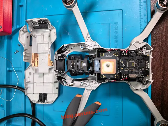

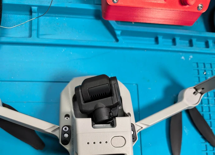

Unscrew the cross screws around the bottom of the drone.

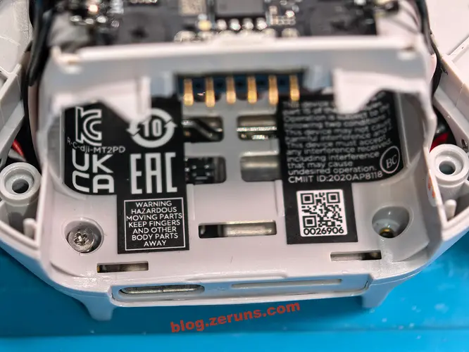

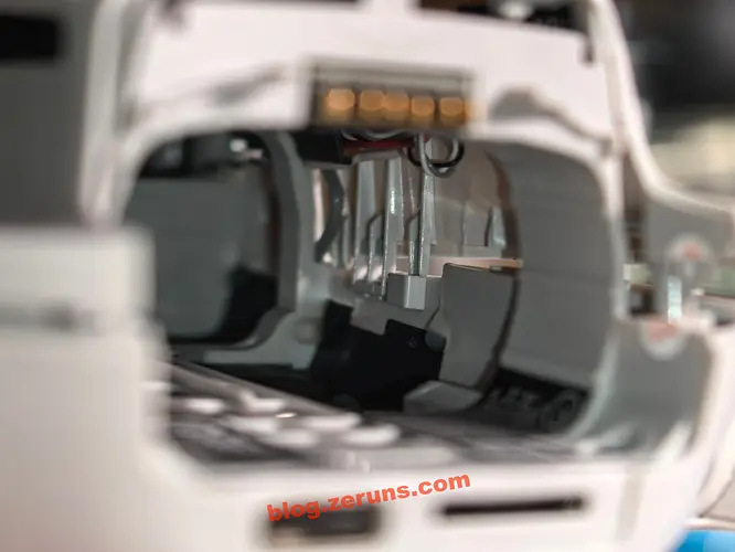

Remove the battery, then pry open the outer shell clips on both sides inside the battery compartment.
You can now remove the upper cover of the case. The ceramic antenna for GPS is directly in the center.

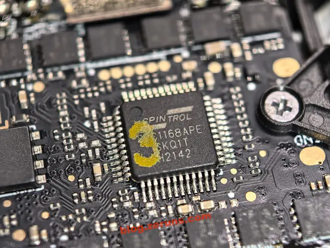

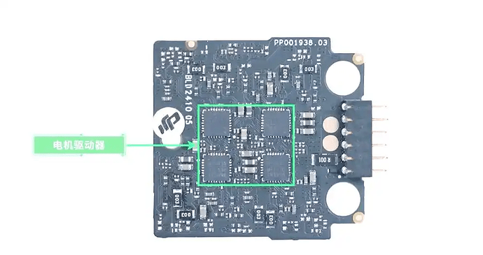

The circuit board below the GPS antenna is the three-phase sensorless BLDC (brushless DC motor) driver board. The chip in the middle of the board is labeled SPC1168APE48 from SPINTROL, a highly integrated SoC microcontroller, likely used for motor control, driving the surrounding MOSFETs to control the motors.
The SPC1168 integrates a high-performance 32-bit ARM Cortex-M4 core, up to 200MHz software-programmable clock, 64KB SRAM, 128KB embedded FLASH, and a wealth of enhanced I/O and peripheral resources. Built-in 14-bit ADC, three programmable gain op-amps, six enhanced PWM modules, three general-purpose 32-bit timers, along with UART, I2C, SPI, etc. communication interfaces, making it an ideal platform for motor control. In addition, it adopts two innovative technologies: a multi-zone safety protection technology for code security and a flexible IO technology similar to FPGA, enabling IOs to be configured as different peripherals for diverse application needs, but with a more cost-effective approach.

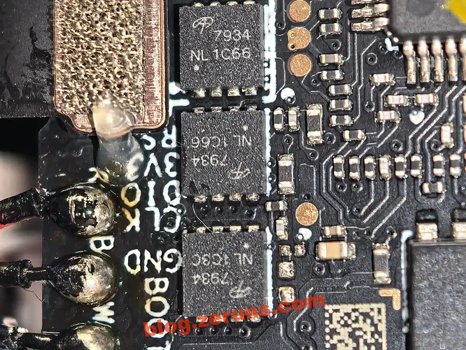

Around the motor driver board are four groups of MOSFET chips (three per group), corresponding to the motors for the four rotors. The MOSFET model is AON7934 from Alpha and Omega Semiconductor (AOS), a dual N-channel MOSFET with two NMOS in a single chip forming a half-bridge.
Key Chip Parameters:
  • Electrical Performance:
    • Drain-source voltage (Vds): 30V
    • Continuous drain current (Id): 16A/18A (different channels)
    • On-resistance (Rds (on)): minimum 10.2 mΩ @ 16A, 10V
    • Input capacitance (Ciss): 485pF
  • Packaging and Reliability: DFN-8(3x3) package, supports -55℃~150℃ wide-temperature operation, meeting the reliability requirements for drones in harsh outdoor environments.

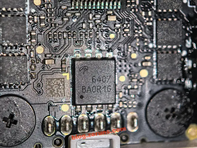

Above the battery interface is an AON6407 chip, also from AOS, a P-channel power MOSFET.
Key Parameters and Features:
  • Electrical Performance: Drain-source voltage (Vds) -30V, continuous drain current (Id) -85A, on-resistance (Rds (on)) 4.5mΩ
  • Packaging: PDFN-8(5.8x4.9)
Function Analysis:
This AON6407 chip serves as the power control switch on the battery power line above the battery connector and undertakes several key functions:
  • Power On/Off Control: Controls the power transfer between the battery and the drone’s main circuit, enabling precise on/off switching.
  • Efficient Power Transmission: With a low on-resistance (4.5mΩ), it reduces power loss during battery supply and improves energy efficiency, indirectly extending drone battery life.
  • Circuit Protection: Can quickly cut off the circuit in case of overcurrent or overvoltage, preventing damage to the battery or backend systems and ensuring power system reliability.
In short, it’s the power “gatekeeper” between the battery and the drone’s core circuits, ensuring efficient power transfer and acting as a safety buffer for the power system.
On the back of the motor driver board are four MP6530 chips from MPS (Monolithic Power Systems), which are gate driver ICs specifically designed for three-phase brushless DC motors. They can drive three half-bridges made up of six N-channel MOSFETs and handle up to 60V.

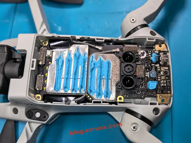

Unscrew the two cross screws under the battery compartment to remove the bottom cover of the drone.
The first thing visible is a large black aluminum alloy heatsink, with a downward-facing camera and infrared range-finding module beneath it.
After removing the heatsink, the shield can and some chips are coated with blue thermal silicone.

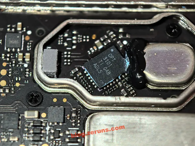

Lift the shield under the TF card slot (the other side of the board is where the downward camera module sits) and you’ll find a OPT3101 chip from Texas Instruments (TI).
Core Attributes & Functions:
  • Technology: Based on Time-of-Flight (ToF) principles, a long-distance proximity and ranging sensor analog front end (AFE).
  • Key Specifications:
    • Ranging distance: up to 15 meters without ambiguity, supports 16-bit distance output and 3mm resolution.
    • Ambient Light Resilience: Excellent sunlight rejection, operates in full sunlight up to 130klx.
    • Integration: Built-in ADC, timing sequencer, digital processing engine, and emitter driver, supporting 3 transmitter channels.
Role in the Device:
As the ToF sensor core, it provides:
  • Precise Ranging: Real-time distance measurement for drones and other devices, aiding in flight control and obstacle avoidance.
  • Environmental Awareness: Identifies the location and distance of nearby obstacles via multi-zone sensing, enhancing smart interaction and safety.
  • Anti-Interference Operation: Not affected by object reflectivity; can output stable depth data even in complex lighting environments.

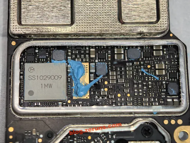

A shield in the middle contains a muRata chip, model SS1029009, suspected to handle video transmission signal modulation/demodulation.

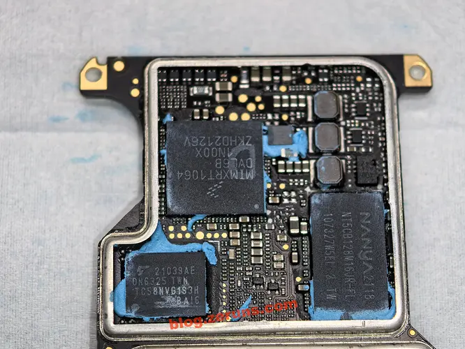

The largest shield encloses three main chips: MIMXRT1064, TC58NVG1S3H, and NT5CB128M16JR-FL.
1. i.MX RT1064 (MIMXRT1064)
  • Brand & Positioning: NXP’s high-performance crossover processor, part of the i.MX RT series.
  • Key Specs:
    • Core: Cortex-M7, up to 600MHz
    • Storage: Supports external DDR and Flash, high-speed data processing
  • Function: Acts as the main controller for the Mini 2, handling flight control, sensor data fusion, and image pre-processing. It’s basically the “brain” of the drone.
2. TC58NVG1S3H (Toshiba Flash Memory)
  • Brand & Positioning: SLC NAND flash from Toshiba
  • Key Specs:
    • Capacity: 2Gbit (256MByte), industrial-grade
    • Features: Supports high-speed read/write, data protection on power loss
  • Function: Stores the drone’s firmware, flight logs, calibration parameters, and other key data to ensure system stability.
3. NT5CB128M16JR-FL (Nanya DDR RAM)
  • Brand & Positioning: DDR3 RAM from Nanya
  • Key Specs:
    • Capacity: 128M×16bit (2Gbit = 256MByte), 1.5V operating voltage
    • Data rate: Up to 2133 MT/s (DDR3-2133), corresponding to a 1066 MHz clock
    • Performance: Supports high data throughput for main chip bandwidth needs
  • Function: As working memory, provides data cache for the i.MX RT1064, ensuring smooth operation for flight algorithms and real-time image processing.
